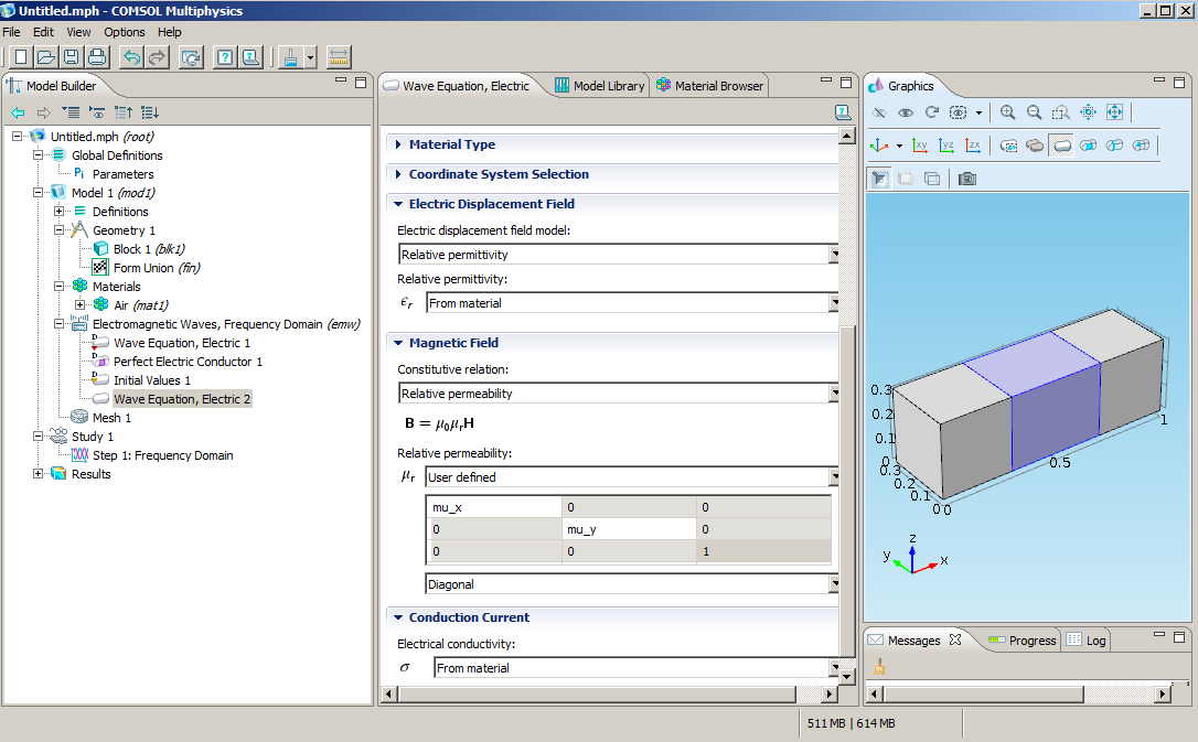

To define anisotropic properties do the following:
1. Right-click “Electromagnetic Waves, Frequency Domain (emw)” node and select “Wave Equation, Electric”
2. Go to “Wave Equation, Electric” setting window and select middle layer in the “Domain Selection” section
3. Under “Magnetic Field” section:
-From the “Electric permeability” list, select “User defined” and “Diagonal”
-In the “mur” table, enter components of relative permeability tensor
Sergei
