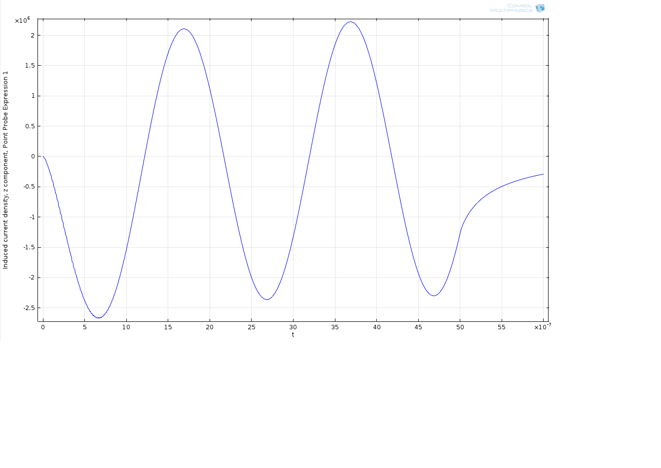

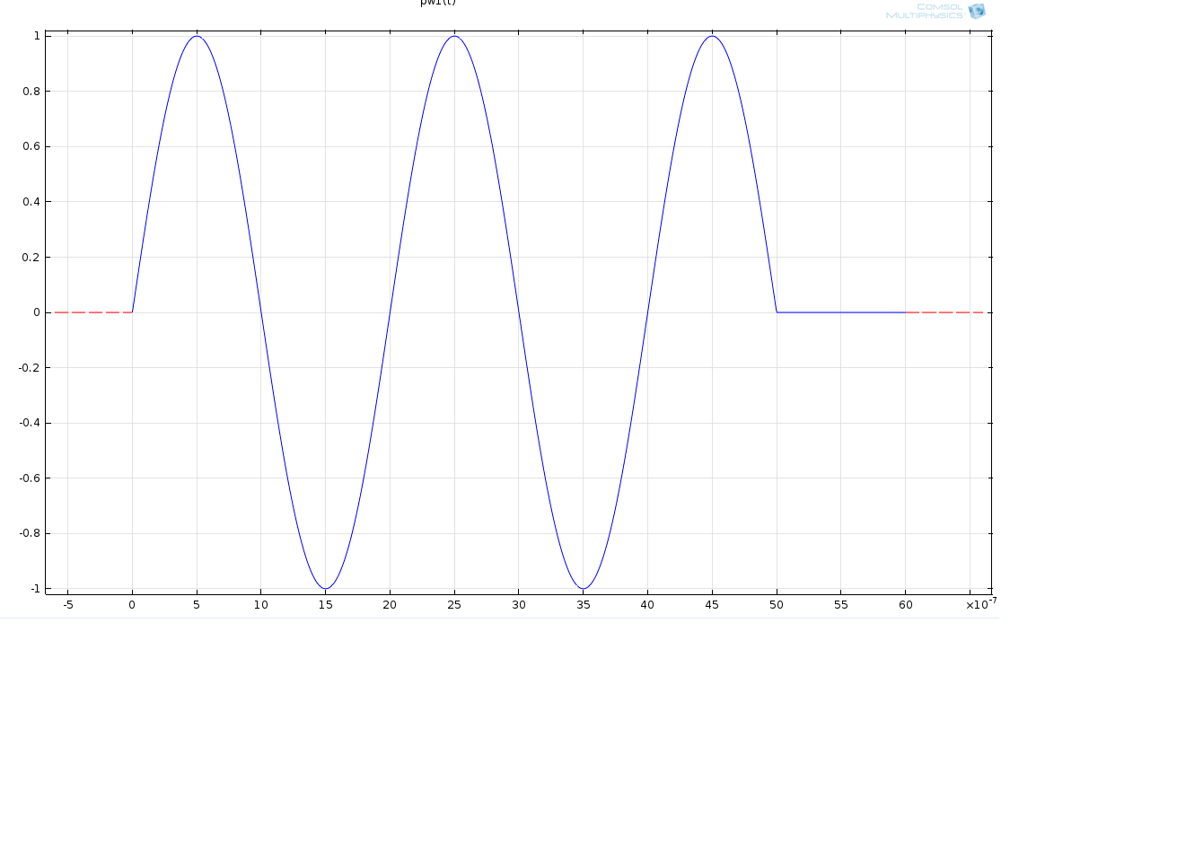

I built a model in COMSOL 4.3a using AC/DC module to simulate eddy current response excited by a linear coil. A sin wave is used as excitation signal in a linear coil, and the response of eddy current density under the coil has distortion in amplitude and frequency of sin waves.
For single frequency, the response should be the same frequency as excitation. Is there any problems in my set-up? Thanks a lot!
Please find the model and signals for excitation and eddy current density attached.

As far as I see it is the same frequency, just with a phase shift, because there are resistive losses in the material.

So how to reduce the phase shift and amplitude attenuation?

The induced current's field will always attenuate the exciting field, that's the nature of induction. Reducing losses will reduce the phase shift.
The question is, what is the purpose of the setup and why do you need to avoid the phase shift? In many applications based on eddy currents it is a desired effect bcause it provides information about the material.
