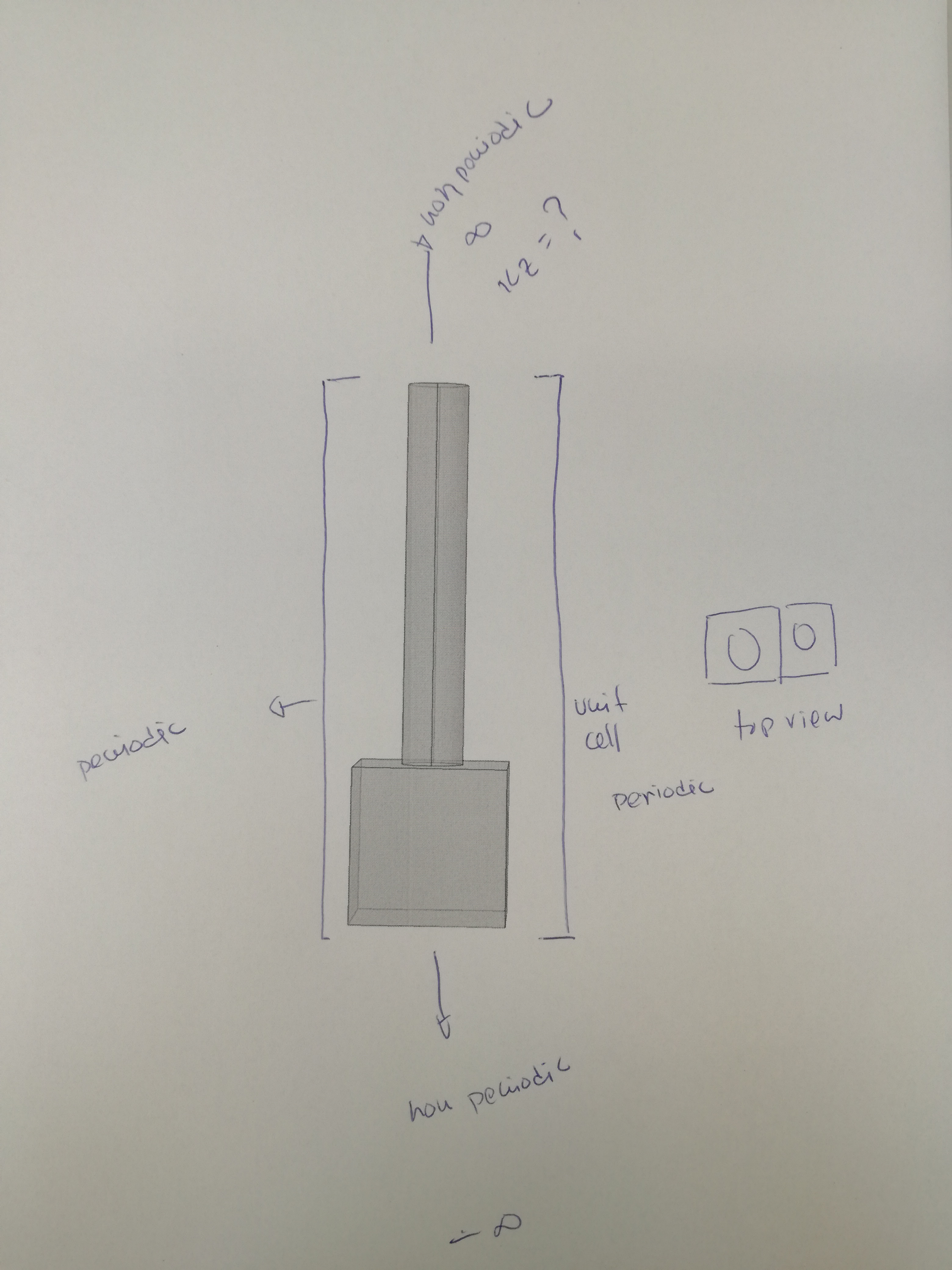

Dear Sir,
I have a small problem.I am working with an geometry which is periodic in 2D(consider a sided square box with a pillar in middle).Left right and front back are periodic.But top and bottom is not periodic and goes to infinity.
Which boundary condition should i use?You can have a look on mz geometry from the attachment.
Waiting for your kind reply.
Best Regards
Anisuzzaman Boni
