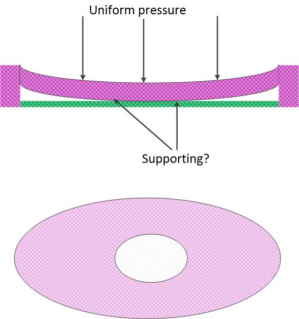

Posted: 1 decade ago 21.05.2015, 22:59 GMT-4
Dear Henrik:
Thanks for your explanation!
I am also doing research related to von Kármán plate theory, I got an analytical solution of
circular plate, and the results match well with COMSOL result when I apply uniform pressure
to plate and the plate deform freely.
But when I underlaid another plate to constrint the deflection greater than a certain value,
the analytical result did not match well with that of COMSOL.
(As in the attachment, the annular part is the top view of the plate in this situation.)
Would you please explain how to add boundary condition or other parameters when
solving this problem?
Thanks!
Wang Jiujiang
