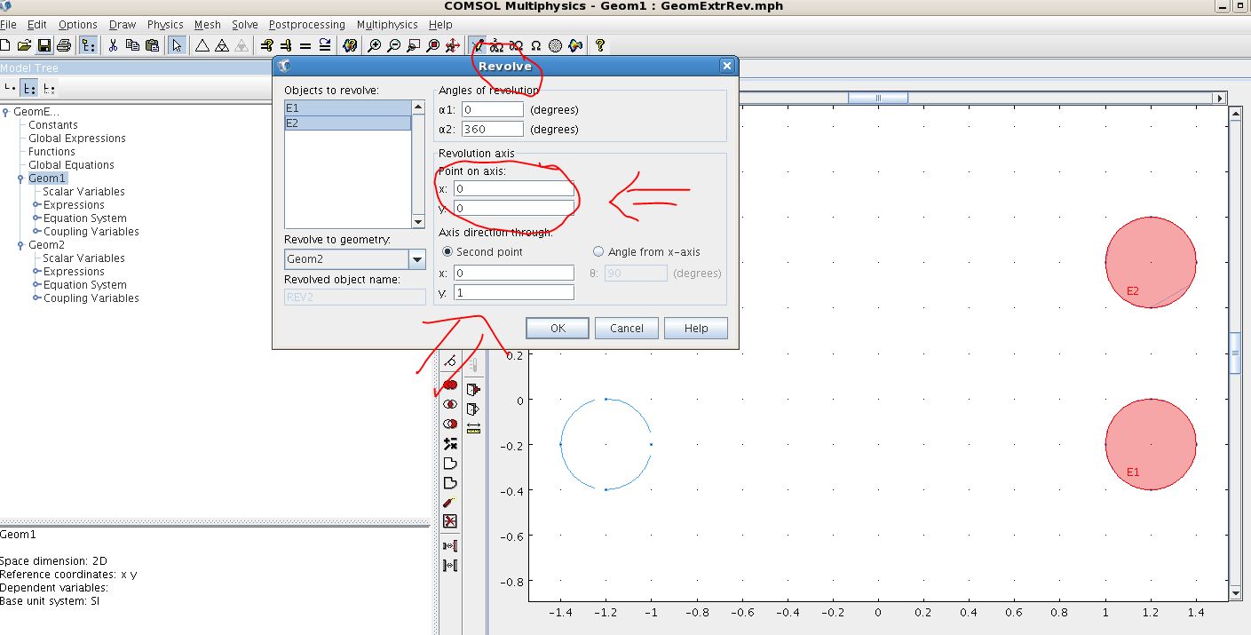

I am trying to achieve a rather simple task and am unable to find a way to do it in COMSOL. I would like to draw a curved 3D tube (with angle alpha). This is a task I would usually expect to be solved by a command like extrude 2D shape along a predefined path, but I just can't find any command to do this. Has anyone ever tried this and found a way? Thank you so much for your help.
Franz
You have the 2D draw "extrude" and "revolve", for which you can "twist" and define an external rotation axis respectively, a simple illustration is given below. Start from a 2D and itwill create your 3D Geom at will
Have fun Comsoling
thank you for your response. I can't find where/hoqw to define an external axis for the revolution of extrusion.
Thank you.
Franz
you should see something like this, no ?
ahhh, now I understand what you mean by "external" axis. Of course, that is a possibility of doing this. Sorry, I just did not think about it that way. I was looking for something like the extrude along path thing. Ok, I see I can solve this particular problem like this, thankl you very much for pointing my head in the right direction; but what would I do if I need a more complex path? I mean do I have to basically split it into several tiny pieces and cunstruct it in this manner?
