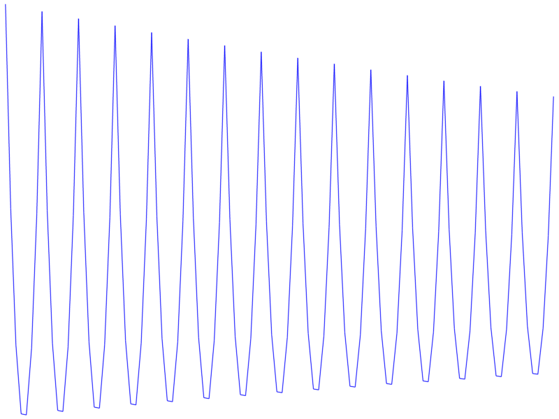

du/dx =u
x in [0,2]
u(0) = 1000
while I was using the General Form PDE in stationary , there are two boundary point in x=0 and x=2.
the default condition is zero flux condition at both ends. However, for a 1st order equation there should be only one boundary condition. zero flux at x = 2 is over-determinant for this problem.
The results obtained is also oscillating as shown in the attachment.
So, my question is: what condition should I impose at x=2? for this kind of equation?

I think the problem is the default behavior of comsol. It impose a default B.C. for 1d-ODE at unspecified end, which make the equation over-determined. I do not know what happend next, but I can still produce a result to meet the over-determined ode.
The general form of PDE in comsol includes d^2u/dx^2 terms, which means it is designed to solve 2nd PDE. I think comsol should have some limit on the coeff. of general form of PDE, or illegal BC will cause misleading and confusing results.
