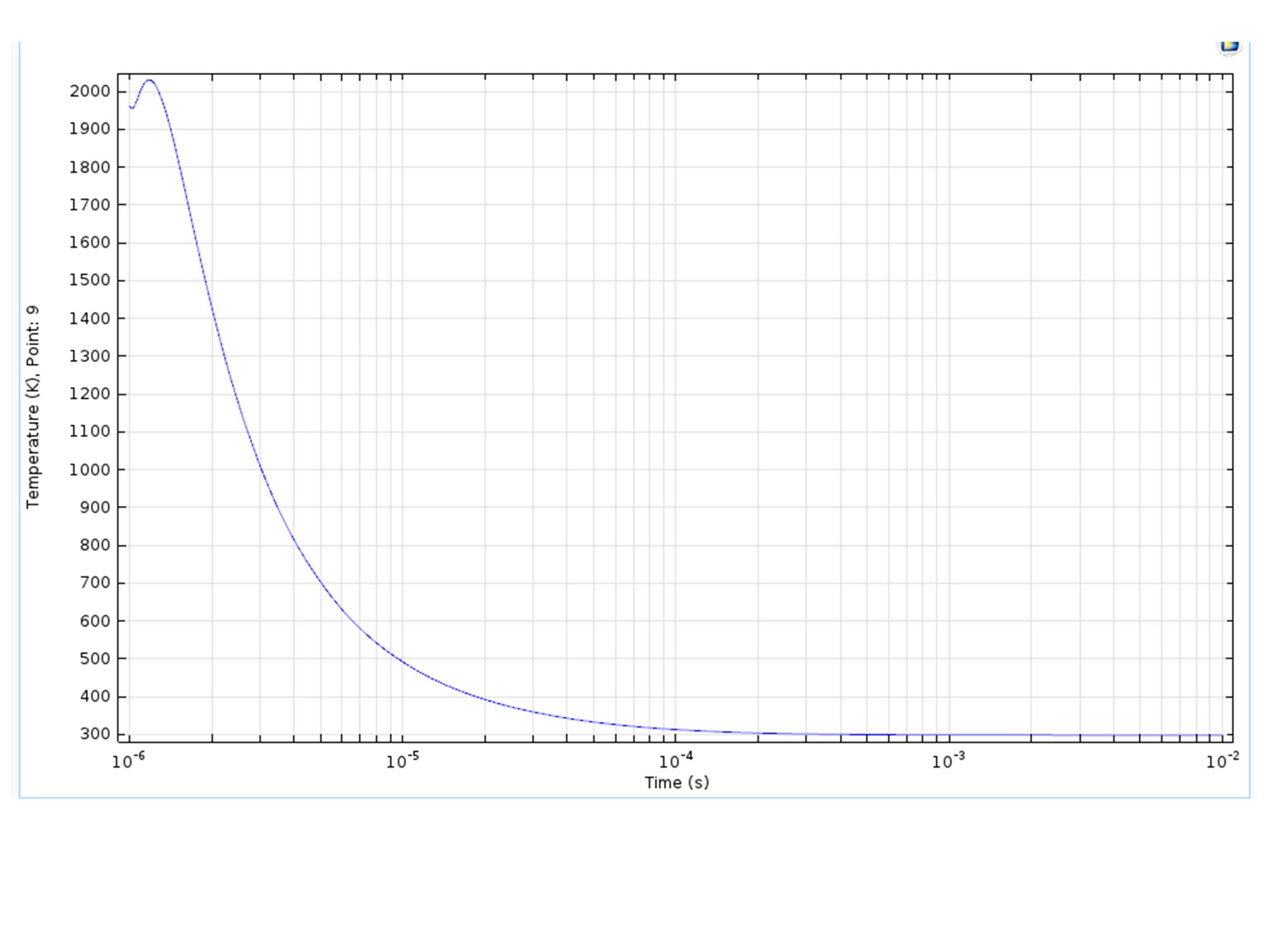

Heat transfer from the solid to the surrounding fluid is taken into account through Newton's cooling law:
q = h·(Text - T)
where Text is the fluid temperature and T is the solid temperature; h is the heat transfer coefficient which depends on materials. For steel-air boundary it is 5-10 W/(m²·K) and for steel-water boundary 300-400 W/(m²·K). Exact values are impossible to give as they depend on the rate of convection, fouling, etc. But I do not think this value plays an important part, because your solid body is very close to 25 °C at all times, hence hardly no heat transfer takes place.
In Comsol this BC is under Heat Flux --> Convective Heat Flux.
Your plate reaches constant temperature of 25 °C in less than 0.5 ms (see attached image).
q = h·(Text - T)
