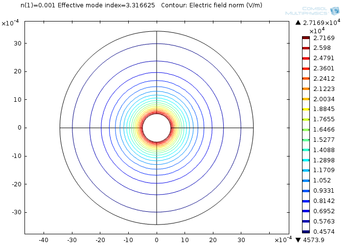

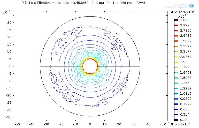

                                                    Could you suggest to make dimensionless. I am using 1 GHz as frequency which means 0.3m would be the wavelength. Now as I am going smaller and smaller it should be much smaller to the wavelength.
Regarding the meshing, i have even tried "Extremely Fine" as Element Size and Refine as 2 to increase the number of elements, still the same issue exist for the um(10^-6) ranged coaxial cable.
The inner cable is of radius 0.5*n and outer one as 3.5*n where n = 10^-6.

                                                    Now even operating the coaxial cable (The inner cable is of radius 0.5*n and outer one as 3.5*n) with  n = 10^-3 at frequency at 1 MHz is also giving the same problem.
Reducing the frequency increases the wavelength hence the ratio of physical size and wavelength decreases. Is there any specific ratio which need to be followed to avoid any this anomaly ?

                                                    I am using the Physics as "Electromagnetic Waves, Frequency Domain" and "Mode Analysis" as Preliminary Study.
The standard equation which is solved is wave equation:
delX (mu_r^ -1 )(del X E) - k^2(epi_r - j sigma/( omega*epio) E = 0
But the real issue which I am facing is that for a particular combination of  dimension of waveguide and frequency of operation I am not getting field patterns similar to theoretical ones.
Outer Radius = 3.43*n
Inner Radius = 0.5*n
Dielectric Constant of material is 11
Conductors are Perfect Electric Conductors.
Till now if for two cases I am seeing discrepancy:
1. Waveguide is of the order of um( n  = 10^-6) and Frequency = 1 GHz
2. Waveguide is of the order of mm( n = 10^-3) and frequency = 1 MHz
The ratio of dimension vs wavelength is same in both cases. I am not sure which limitations am I hitting ?
