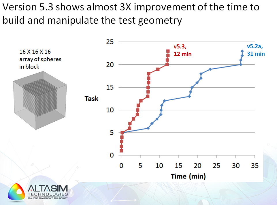

We also work with models with a large number of geometric entities (~4k domains, ~32k boundaries) and need to do Boolean and other geometric operations.
A couple years ago I came up with a non-proprietary benchmarking model which is simply a 16 X 16 X 16 array of spheres inside of a block. The time to generate and finalize and manipulate this test case is comparable to the real scenario of interest to us (and may be for you, too, David).
I have uploaded a graphic showing a comparison of this benchmarking example between v5.2 and v5.3 on my machine (specs in excel file). I have also uploaded an excel file with the steps to perform this benchmarking example yourself on your system. The excel file includes the time breakdown as well as memory usage and file size.
Great news! In summary--v5.3 released earlier this year--shows almost *3X* improvement of the time to build and manipulate this test geometry.
Many thanks to the COMSOL team!
