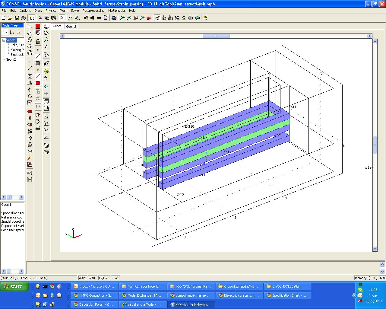

Here's what I tried. I draw my 3-D structure by first defining a 2-D workplane (call it G2) and then extruding it to 3-D (call it G1). I have attached a screen shot of G1. The big block at the bottom is a substrate, the block above it is air. The coloured U-shaped blocks are various materials, the uncoloured U-block is air. The various sub domains are a misguided attempt to manually divide it into rectangular blocks (cuboids).

In that screen shot, if I try to generate a swept mesh in the substrate by sweeping from the front face to the back, or one side to the other, I get an "invalid topology" error. I can only guess this is because the top surface (which is not the source or destination in the sweep) has a boundary with the U section above it. But you say this should not be a problem?
