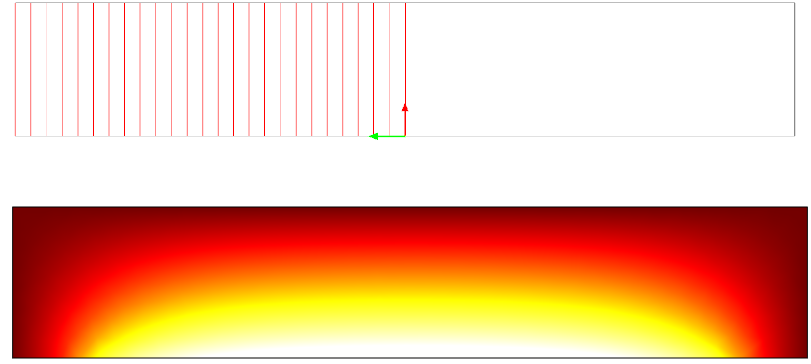

I'm kinda confused with averaging of the temperature.
I have a certain surface heat distribution in a disk cross-section - see Pic1.png.
1) I created 2D Cut Line in Data Set with additional parallel lines [range(1,1,25)]
2) I plotted Temperature dependance along red-arrow for these 'parameters' (see Pic2.png).
All works fine. However, I would like to plot average temperature along red-arrow for every 2D Cut Line, literally - average temperature distribution along the radius of the disk.
