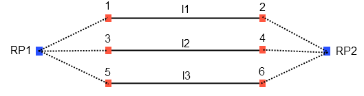

In the attached file you will find a figure illustrating what i exactly want to do :
The whole problem is defined by 3 subdomains on which there are 3 differents subdomain-settings. The point is that i would like to introduce coupling between points 1,3,5 and coupling between 2,4,6. So i wonder if i can define 2 reference points RP1 and RP2 and define a "link" between 1,3,5 and RP1 and an other "link" between 2,4,6 and RP2.
Maybe it is posible to define coupling equations between the different boundaries, but i don't know how to do it.
Tanks !
In the attached file you will find a figure illustrating what i exactly want to do : The whole problem is defined by 3 subdomains on which there are 3 differents subdomain-settings. The point is that i would like to introduce coupling between points 1,3,5 and coupling between 2,4,6. So i wonder if i can define 2 reference points RP1 and RP2 and define a "link" between 1,3,5 and RP1 and an other "link" between 2,4,6 and RP2. Maybe it is posible to define coupling equations between the different boundaries, but i don't know how to do it. Tanks !
Posted: 2 decades ago 03.10.2010, 02:42 GMT-4
you have to better define what you mean by "link", in principle this is possible for most cases, via coupling variables, predefined BC's or weak constraints all depends what kind of physics you have (and via the weak constraints you have mono and bidirectional links)
Hi you have to better define what you mean by "link", in principle this is possible for most cases, via coupling variables, predefined BC's or weak constraints all depends what kind of physics you have (and via the weak constraints you have mono and bidirectional links) -- Good luck Ivar
Posted: 2 decades ago 04.10.2010, 15:36 GMT-4
Let's imagine that my problem is made of 2 variables u and v. On boundaries 1,3,5 i want to set u(1)=v(1)= u(3)=v(3)= u(5)=v(5)=0.
Then on boundaries 2,4,6 i want to set u(2)=u(4)=(6)=C ; where C is a constant that I impose.
So there is no difficulty for this.
And I want v(2)=v(4)=v(6) but I don't now how to impose this equality.
Do I have to define a coupling variable w, so that I will set v(2)=v(4)=v(6)=w (where w is free) ?
Thanks
Let's imagine that my problem is made of 2 variables u and v. On boundaries 1,3,5 i want to set u(1)=v(1)= u(3)=v(3)= u(5)=v(5)=0. Then on boundaries 2,4,6 i want to set u(2)=u(4)=(6)=C ; where C is a constant that I impose. So there is no difficulty for this. And I want v(2)=v(4)=v(6) but I don't now how to impose this equality. Do I have to define a coupling variable w, so that I will set v(2)=v(4)=v(6)=w (where w is free) ? Thanks

Posted: 2 decades ago 05.10.2010, 10:25 GMT-4
I've managed to do what i want, using integration coupling variables,
Thanks for your time !
Hi, I've managed to do what i want, using integration coupling variables, Thanks for your time !
