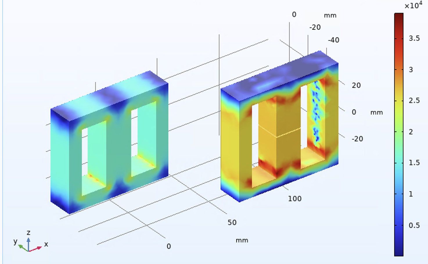

Modified E-Core Model , but the results are reflecting the original one with duplicated the core
Hi COMSOL Members,
I started my model with using the COMSOL provided model for E-Core Transformer. https://www.comsol.com/model/e-core-transformer-14123. I modified the gemotry using a specific parameters with intrudcing a gap in the core. Every thing with edited the geomtery went smooth. However, after running the model, the results does not reflect any impact of the change. After a deep looking, I should the results have two cores which are the original core and the modified core as shown in the picture. Modified Model is attached.
