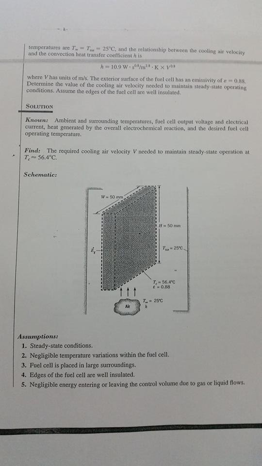

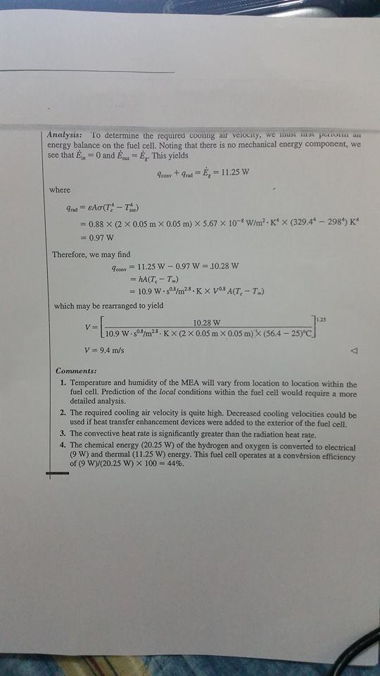

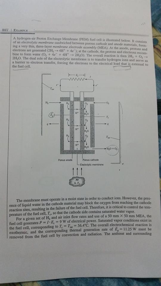

i have a question in my heat and mass transfer book and i want to do it on COMSOL, but iam still new on COMSOL, so can anyone tell me the steps that i should go through inorder to do the question on COMSOL.
i have attached the question.
