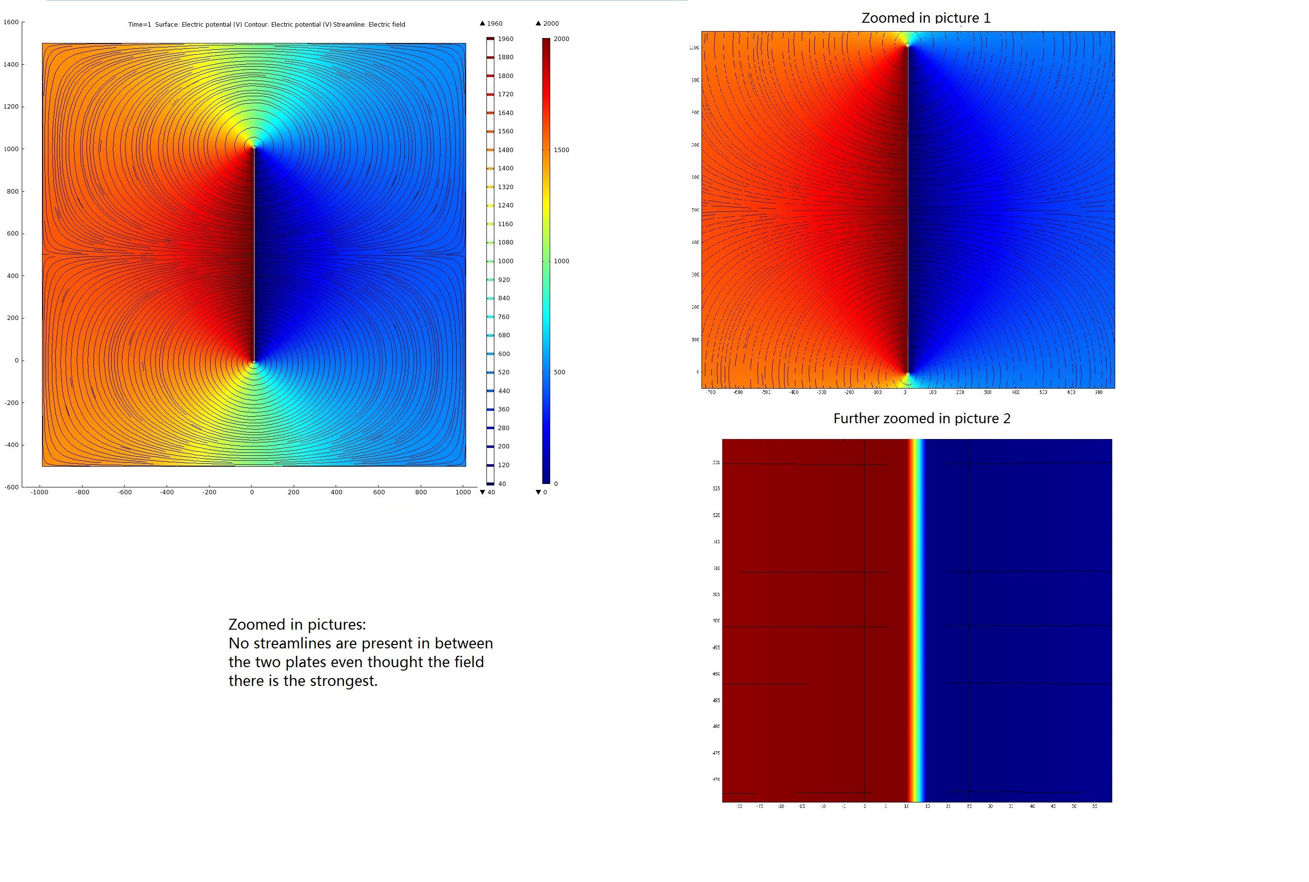

But say for two parallel plate electrodes, the electric field is strongest between the plates but when i simulate it using COMSOL, the streamlines don't show the strength of the field, they show the field lines even behind the two plates in more density if not equal. So how do i get a more physical representation of the electric field?
Is there any plot i could do that would, say give me magnitudes of the electric field along different planes in my model?
or something to give a more physically accurate description?
I am attaching a picture of the parallel plate electrode problem.
Okay. Thank you. But say for two parallel plate electrodes, the electric field is strongest between the plates but when i simulate it using COMSOL, the streamlines don't show the strength of the field, they show the field lines even behind the two plates in more density if not equal. So how do i get a more physical representation of the electric field? Is there any plot i could do that would, say give me magnitudes of the electric field along different planes in my model? or something to give a more physically accurate description? I am attaching a picture of the parallel plate electrode problem.
Posted: 1 decade ago 19.02.2015, 22:33 MEZ
Streamlines are not well suited to show the field strength. You have to realize that they show the direction of the field vector, not the magnitude.
It is possible to visualize field strength by choosing a high density of start points where the field strength is high.
If you want to visualize the electric field I would recommend a surface or contour plot of the field, not the potential. Your plot is a surface and contour plot of the potential, not the field.
I guess you don't find streamlines between the plates because you chose the start points outside the capacitor. The streamlines then loop from one exterior plate surface to the other arond the capacitor. They cannot penetrate the plate because there is no field inside the conductive plate.
Almost all about the correct use of streamlines is about the choice of the start points. If you chosse them in a proper way they are nice for qualitative visualization, but they are mostly useless for quantitative purposes.
